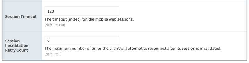

One of the new features in Ignition v7.9.9 involves the Ignition Mobile Module. The Mobile Module allows you to use Ignition on mobile devices that can’t install Java, letting your users take Ignition wherever they need to go on the plant floor. In a perfect world, those devices would be on perfect networks that never drop connections, but that doesn’t happen in real life. When the project is set up for auto-login, users expect that the session will automatically reconnect, and they are frustrated when that doesn’t happen. However, you don’t want Ignition mobile clients to continually try to reconnect if your network is down for legitimate reasons.
To help with this issue, we’ve added a new Session Invalidation Retry Count property for your mobile projects. This lets you set the maximum number of times a client will reconnect after a session is invalidated and fine-tune it to your needs — high enough that your users will have a good experience when the connection is dropped, but low enough that Ignition is not continually trying to reconnect when there’s no hope that it will.
The new Session Invalidation Retry Count property in Ignition v7.9.9
