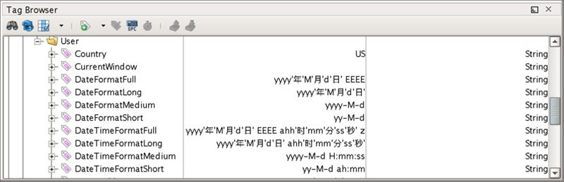

Ignition lets you customize dates in a number of places using date format strings. When changing from English to French, the date formatting automatically changes words with the locale, like changing “Wednesday” to “mercredi” and “June” to “juin,” but does not automatically change from “6/5/2017” to “5/6/2017.”
To help automate these changes, we’ve added 12 new system tags to give you a full range of date and time formats that change when the locale changes. You can bind these tags to places that expect a date format string, and when the locale changes the value of the tag will update, which will keep your dates and times in a format your user understands and expects.
Data Format US
Date Format Chinese
We’ve also added date formatting options to datasets through the new system.dataset.formatDates() scripting function. This will allow you to pass in a dataset and any valid date format string, and get back a new dataset with the dates correctly formatted in the locale of your choosing. This will make it easy to localize datasets before exporting to Excel, CSV, or HTML.
