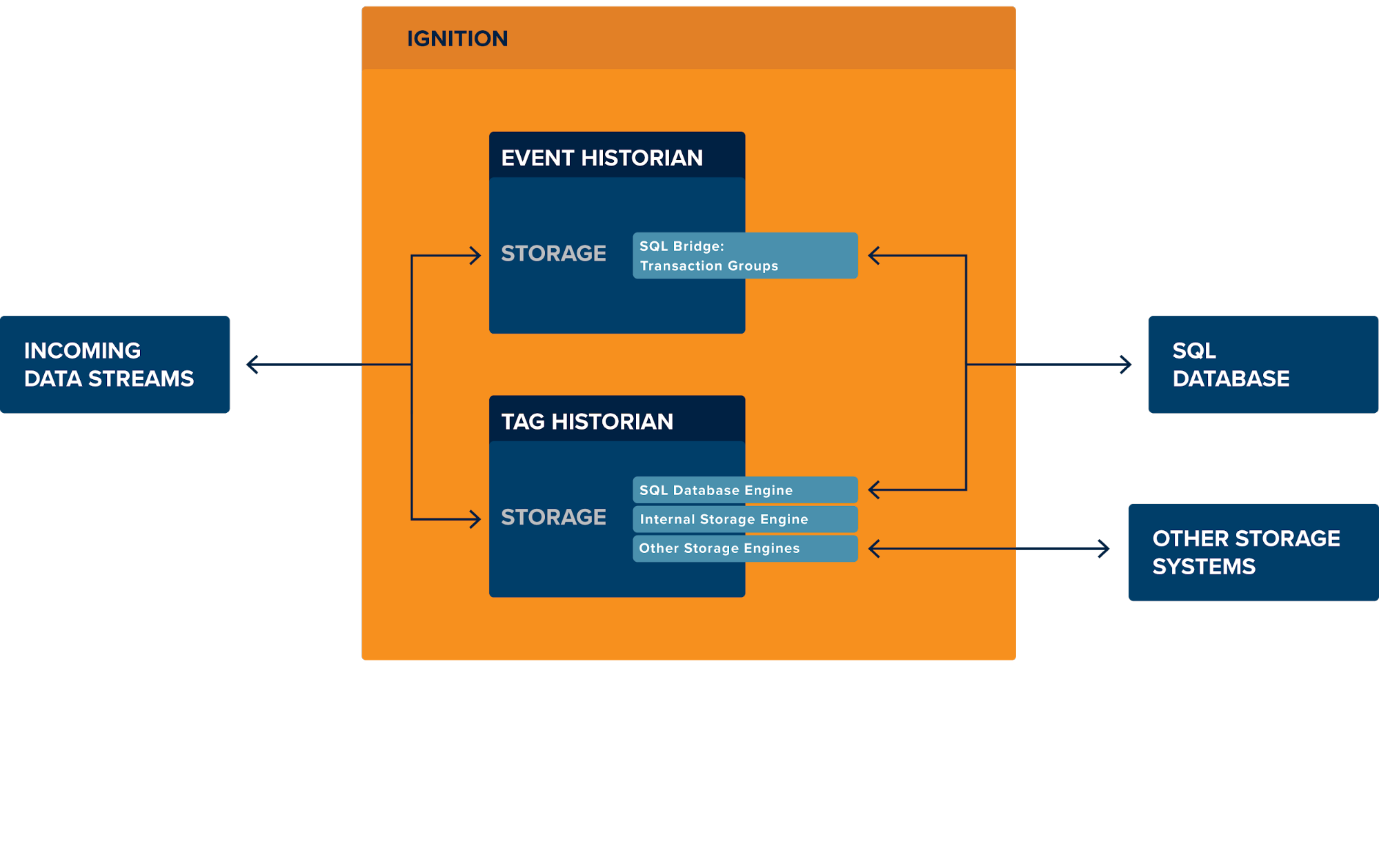

Overview
Ignition’s data historian functionality is a robust set of features that are built into Ignition modules, providing data acquisition, storage, retrieval, and visualization.
As with everything else in Ignition, data historian functionality is modular. Several modules are often used together to provide a complete system. Often, users combine Ignition’s data historian functionality with SCADA, HMI, IIoT, ERP, or MES functionality.
Although many people think of Ignition’s Tag Historian Module as the “Ignition Historian,” a full data historian often is described by not only storing tag data, but also storing event-based data and providing visualization. As such, this document covers the modules for those features.

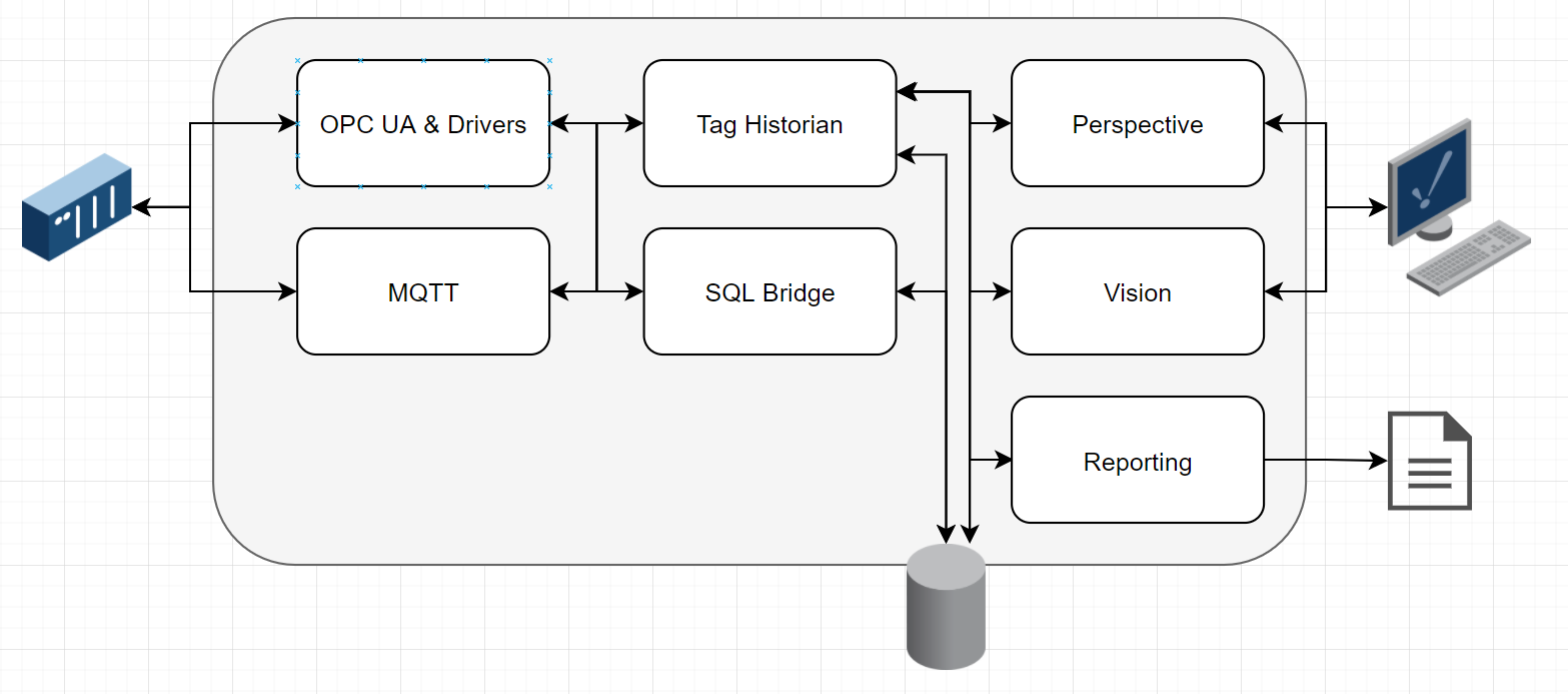

Modules
Â
Ignition’s modular architecture allows for the choice between using a single module or using multiple modules for a given installation. The bare minimum needed to use Ignition as tag historian software is the Tag Historian Module. Many companies use more modules, especially if event-based storage is needed or direct device communication will be used. The modules that are used in a typical system are outlined below.
This provides storage and retrieval of historical data through Ignition’s tag system. Incoming tag changes can be piped to data storage, and tag history can be retrieved through the module.
Storage
Storage of data by the Tag Historian Module can go to several locations. Internal storage is available to store small amounts of data within Ignition itself. SQL-based storage is the normal recommendation for most systems, and pipes data through to an attached SQL database. Additional storage engines are available from third-party developers, some of which can be found on the Module Showcase. Regardless of the storage engine, the Tag Historian Module offers tools for data storage rates, compression, deadbands, and a number of other features.
Retrieval
The Tag Historian Module can be used to retrieve history and perform calculations and aggregations on historical data. Depending on the storage engine being used, the Tag Historian Module will either perform the retrieval directly and perform any appropriate aggregates, or in the case of using third-party storage engines, the Tag Historian Module will pass the request through to the storage engine.
SQL Bridge Module
This module provides Transaction Groups, which are used for event-based logging. Data is stored into SQL database tables, and options are provided for storing quality codes, timestamps, auto creating configured tables, data rates, scheduling, and more.
OPC UA & Driver Modules
These modules provide data collection. The OPC UA Module acts as the foundation for Ignition’s drivers, which offer native communication to a large number of devices. It should be noted that Ignition can also connect to third-party OPC servers for data collection, either through the platform for OPC UA connections, or through the OPC COM Module for OPC DA connections.
MQTT Transmission, Distributor, and Engine
These IIoT modules can be an integral part of data collection when using modern architectures. MQTT Engine plugs right into Ignition’s Tag Historian Module to feed data through. It also includes event storage through DRecords, which place data in database tables which create records similar to Historical Transaction Groups.
Perspective / Vision Module
Sometimes visualization is part of a requirement for data historian software. Perspective and Vision are visualization systems that provide simple, easy-to-use screen building tools to create dashboards, desktop applications, web pages, and on-screen reports.
Reporting Module
Although often not included in a data historian, the Reporting Module is worth mentioning, since it allows for generation and automatic sends of PDF reports directly from within Ignition.
Ignition Platform
Although this isn’t a module, the platform itself is worth noting as it provides a number of features. In addition to providing the required subsystems, like the tag system, the Ignition Platform also provides scripting support to react and respond to tag changes in real time, and includes an expression language that allows for tags that are based on equations or calculations.
Data Storage
Data storage of event-based data through SQL Bridge is stored in SQL databases. SQL Bridge allows users to define table names and columns, and choose what to store and upon what triggers. Historical Transaction Groups are a good choice for most event-based logging.
Data Storage of tag-based data through Tag Historian can go to several locations. Most users target a SQL database. Other possibilities include a small internal storage system and third-party storage engines, many of which can be found on the Module Showcase.

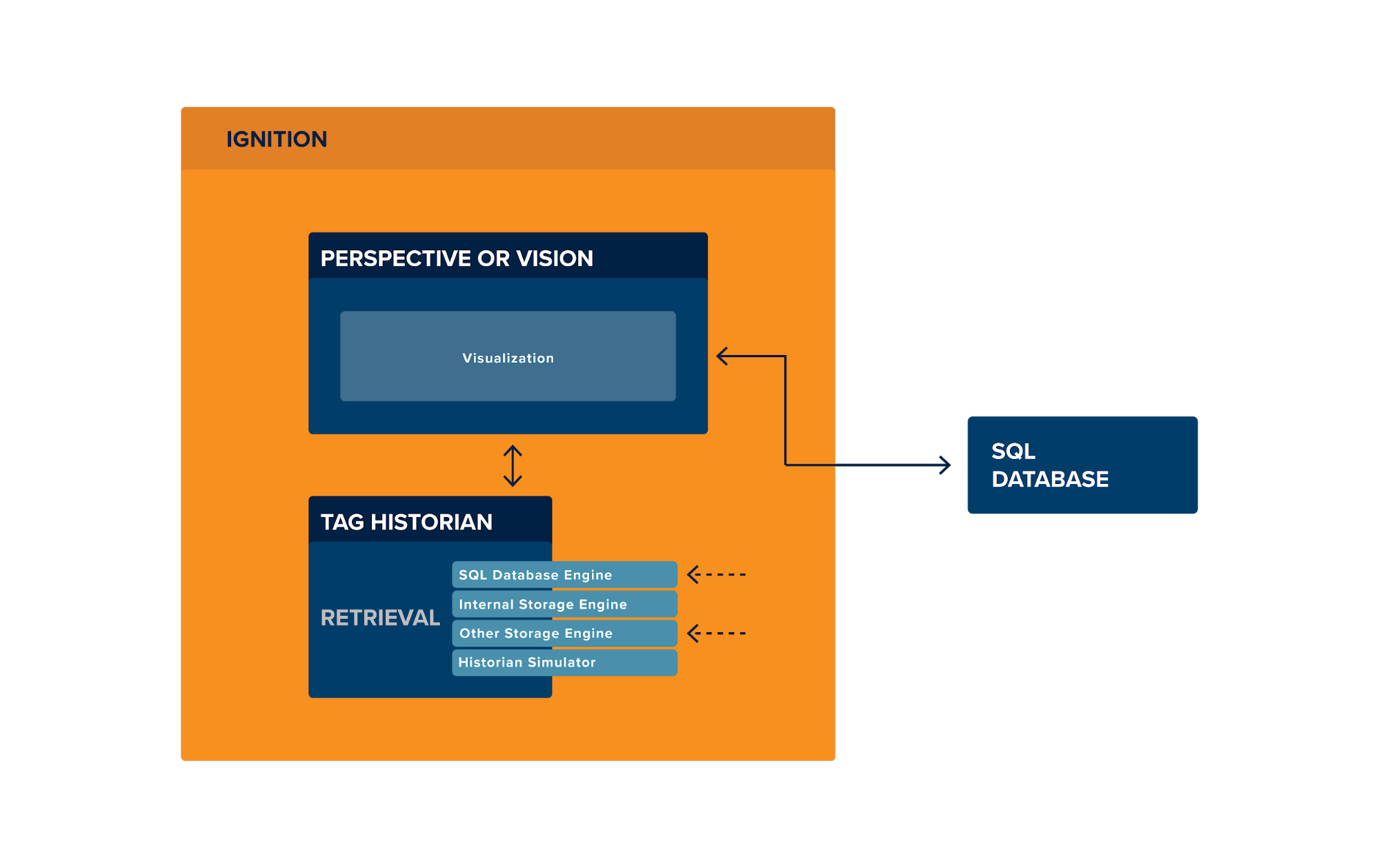

Data Retrieval
Using Ignition’s visualization tools
When using Perspective or Vision, Ignition provides a nice set of built-in tools for data retrieval. For Tag History, this includes Tag History bindings, a data source type for the Reporting Module, automatic integration with some charting components, and some drag-and-drop configuration in the design tools. For event data that’s stored to a SQL database, Ignition has Named Queries that allow for retrieval including support for conditions, date and quality limitations, and anything else that SQL syntax allows.
For use with external tools
For event data, external tools can query the database directly, making everything accessible to parties that have appropriate security permissions.
For tag historian data, it is recommended that external tools query data from Ignition’s APIs. This is useful so any data retrieval goes through Ignition’s logic that provides interpolation, aggregation, partition spanning, and any other logic needed for tag data retrieval. The API function for retrieving this data is system.tag.queryTagHistory(), and setting up a REST endpoint for that function is simple using the WebDev Module.
It should also be noted that Ignition’s automatically-created database tables are fully and publicly documented for those users who do wish to directly query the tables instead of using the recommended queryTagHistory() function.

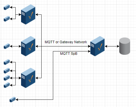

Data Collector Architecture
PLCs or other devices communicate with data collectors in the field. Those data collectors could be Ignition, Ignition Edge, or systems that speak MQTT Sparkplug B natively. Additionally, some devices speak MQTT Sparkplug B natively with history transfer and store & forward supported. Those devices can often communicate directly without a separate collector.
Collectors are optional. Depending on the industry, they can make sense from a bandwidth, network segmentation, and security standpoint.

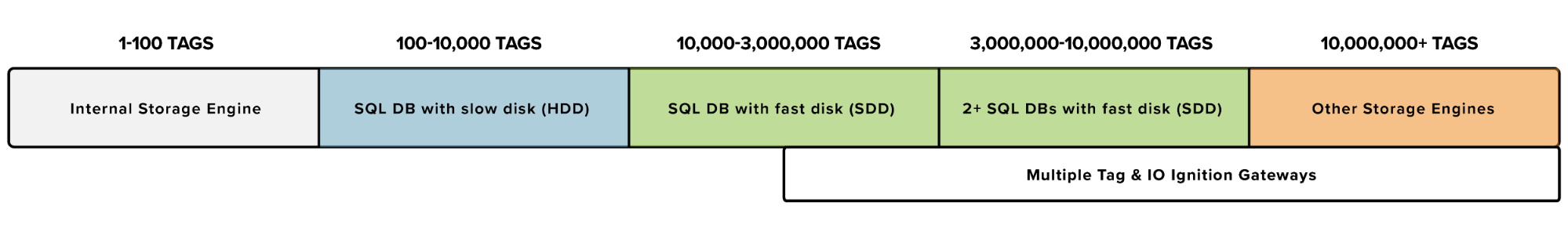

SSD or HDD?
Inductive Automation highly recommends using an SSD both for the Ignition installation and for the database storage if medium-low, medium, or high throughputs are expected. If only low history throughputs are expected, an HDD may suffice. If choosing an HDD, testing the database’s throughput would be recommended to ensure an HDD will handle the required storage speeds.
Internal Historian
The internal historian is a disk-based historian, available directly inside Ignition. This can be a great way to store a small amount of data at remote locations or locations where a SQL database isn’t available.
The data is set to be limited by default to 1 week of data. Although that limit can be expanded, Inductive Automation doesn’t recommend storing years of data in the internal historian, as the internal historian is only intended for small amounts of local history. If you calculate out your needed timeframe to log, your rates, and your change percent, we recommend keeping the total records around 10 million rows. As the internal historian doesn’t have some of the advanced features of the SQL Database storage like automatic partitioning, anything planned for storing over 10 million records should use SQL Database storage or another storage engine.

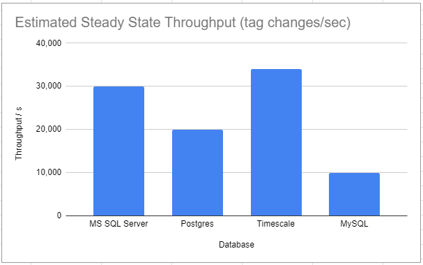

SQL Database Benchmarks
Test System
| Platform | Windows |
| CPU | Intel Core i7-4790K (4/8 core, 4GHz) |
| RAM | 16GB |
| Drive | Samsung SSD 860 EVO 2TB |
Â
Notes:
- These benchmarks are estimates only. Hardware differences and many other factors can have a significant impact on throughputs.
- These estimates are based on steady state throughputs. Having reasonable Ignition Tag Historian partition sizes configured will help to keep performance from degrading in most databases. Timescale is the exception on this list, as it doesn’t experience degradation over time.
- Oracle isn’t included on this list as Inductive Automation does not have an Oracle enterprise license. The lightweight Oracle Express was tested and had similar performance to MySQL, but it’s expected a full version of Oracle would have significantly better performance.

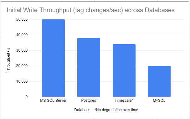

These Initial Write benchmarks are included just for reference. Most databases have high performance on initial throughput and that speed then drops until they reach a steady state. The first image above captures that steady state. If you’re running your own tests and the initial results are showing higher throughput, be sure to let the system run for a few hours or a few days to let the rates even out.

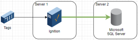

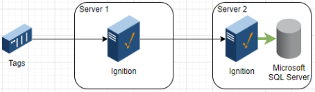

Throughput vs Network Quality
Network quality throughput testing was performed using Microsoft SQL Server. It is believed to be a reasonable expectation that other databases follow similar performance characteristics when it comes to network latency.
Scenario 1
Â
| Â | Â | Latency (Server 1 to Server 2) | ||||||||
| Â | Â | 0ms | 1ms | 5ms | 10ms | 20ms | 50ms | 100ms | 150ms | 200ms |
Dropped Packets (Server 1 to Server 2) |
0% | 30 | 19 | 17 | 15 | 12 | 9 | 6 | 4 | 3 |
| 2% | 22 | 4 | 3 | 3 | 2 | 2 | - | - | - | |
| 5% | 10 | 1 | 1 | 1 | 1 | - | - | - | - | |
| 10% | 1 | - | - | - | - | - | - | - | - | |
| 15% | - | - | - | - | - | - | - | - | - | |
| 20% | - | - | - | - | - | - | - | - | - | |
Scenario 2
Â
0% | 30 | 30 | 30 | 30 | 30 | 30 | 30 | 26 | 20 |
| 2% | 30 | 30 | 30 | 30 | 30 | 30 | 19 | 14 | 12 | |
| 5% | 30 | 30 | 30 | 30 | 30 | 19 | 11 | 9 | 7 | |
| 10% | 30 | 22 | 21 | 20 | 17 | 10 | 9 | 7 | 5 | |
| 15% | 20 | 14 | 13 | 12 | 11 | 7 | 6 | 5 | 3 | |
| 20% | 5 | - | - | - | 6 | - | - | - | - | |
All results are rated in thousands of tag changes per second.
As can be seen in the numbers, Ignition is much more resilient in Scenario 2, where a performance degradation can’t even be seen until there are a significant percent of dropped packets or over 100ms latency. This testing was performed with large numbers of tag changes at a one-second rate.
