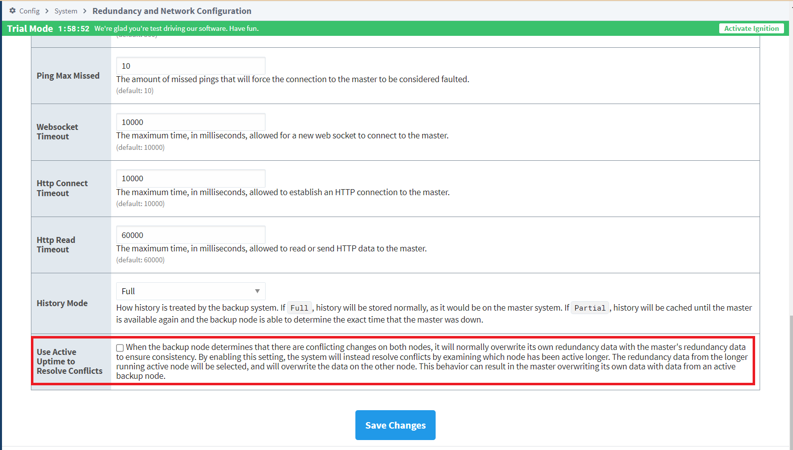

You’ve probably heard someone use a variation of “I’m older; I know better” to win an argument. Sometimes it even works (not on me though). Starting with Ignition 8.1.31, when there are conflicting changes between redundant nodes, you can choose who wins and therefore overwrites the data on the other node.
Previously, these types of conflicts would always be resolved by using the master node’s data, regardless of how long either node had been active. On the Gateway Config page, there is now a checkbox to allow a system with redundancy to use the backup's data to resolve conflicts between nodes if the backup has been active longer than the master.
Active Uptime
Redundancy, as a concept, is all about making sure that no data is lost. For Ignition users who depend on redundant servers, this new option guarantees that no data will be stranded and subsequently overwritten if it exists solely on a backup node.

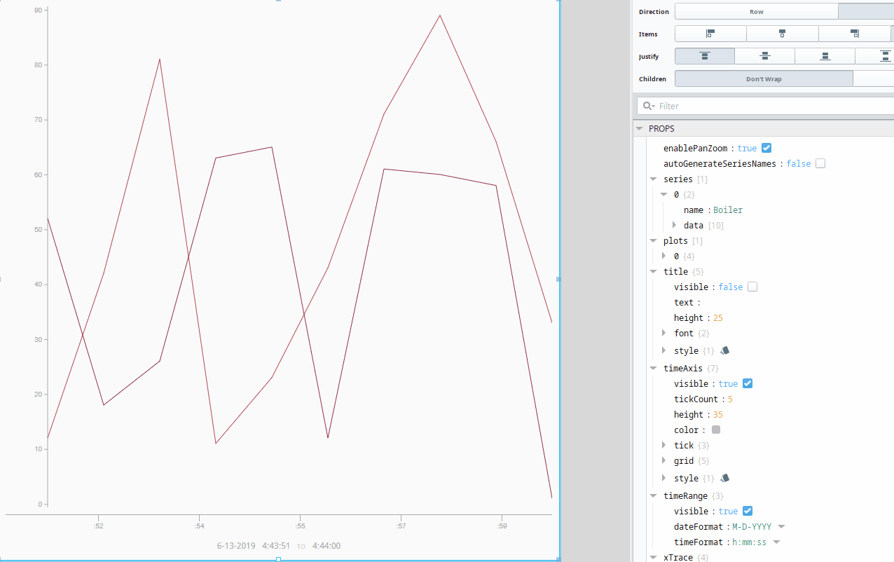

8.1.31 also fixes a Time Series Chart issue caused by logic that automatically generated series names. This logic now can be toggled on or off using the "autoGenerateSeriesNames" checkbox.
Time Series Logic
