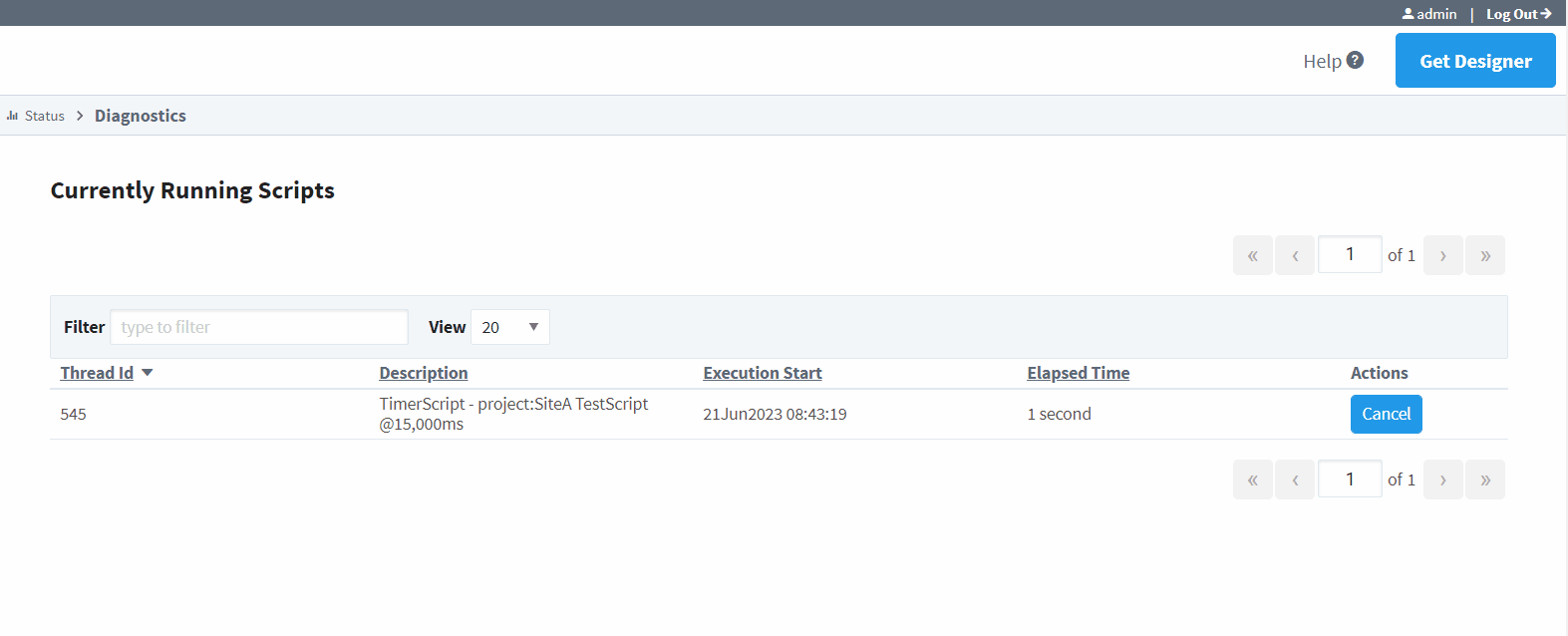

The first improvement on our speedrun concerns the Gateway Status page. In Ignition 8.1.29, the visibility of the Cancel button in the Currently Running Scripts section now depends on the user’s permissions. If, for example, a user has access to the Status page but not the Config page, that user will not be able to cancel a script while it is running.
This update is a useful security measure for administrators who want to prevent status-only users from canceling things like gateway-level scripts that could have far-reaching consequences.

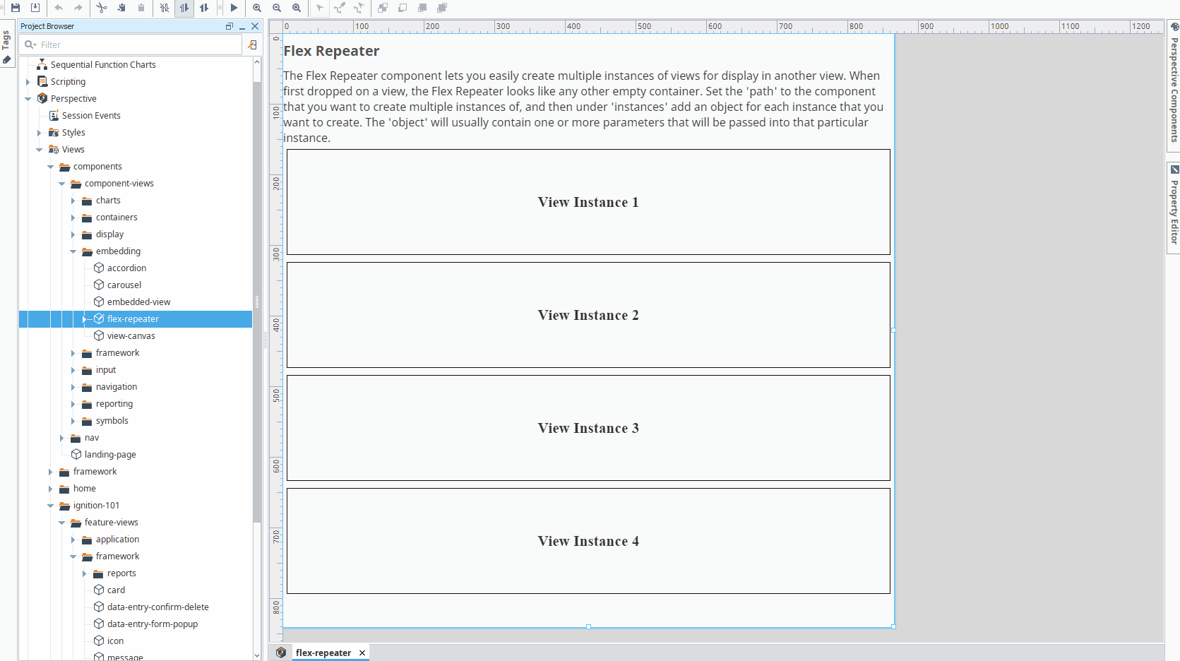

8.1.29 adds a new button in the Property Editor for any component with path property. Pressing this button will take you directly to the Source View along that path. The GIF below demonstrates how to use the button with a simple Flex Repeater Component.

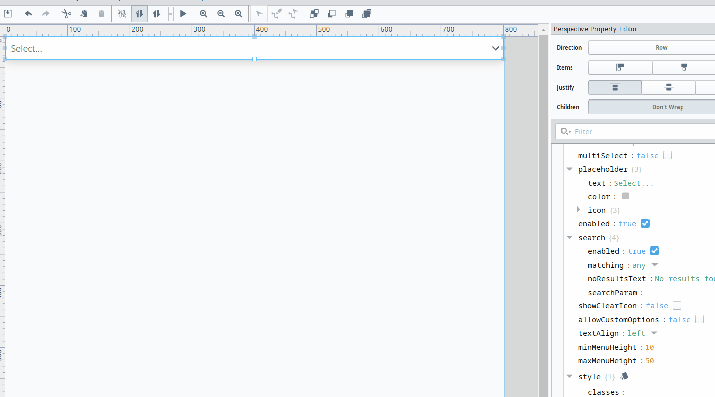

8.1.29 also adds the new maxMenuHeight and minMenuHeight properties to the Dropdown Component to give more menu height flexibility. Previously, the Dropdown menu height was hard-coded and unchanging, like a brick wall, except the bricks were selectable options. Now, you can adjust the menu to better match the number of options you wish to show at any given time.

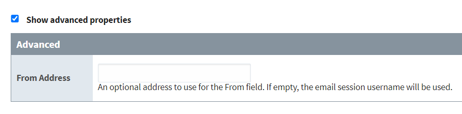

Simple one-way email notification profiles in Ignition and Ignition Edge now contain an optional From Address field. This advanced property option lets you specify a “from” address to adhere to requirements for certain SMTP servers.
