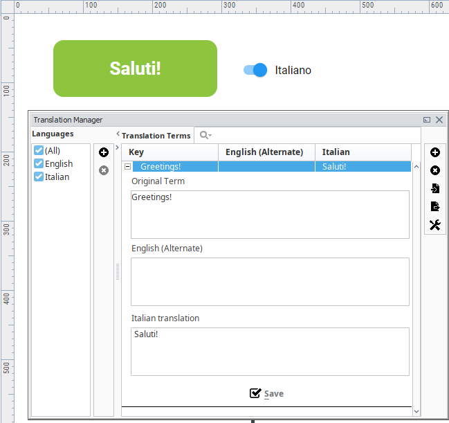

Translation in Perspective
Vision features translation capabilities, allowing you to develop projects that support multiple languages. With 8.0.2, Perspective now includes translation support. As an added bonus, both modules utilize the same translation terms, allowing you to define terms once, and reuse them in both Perspective and Vision.
Translation in 8.0.2 translate
In Perspective, translations are tied to your browser’s locale. The locale is determined automatically, but can also be changed via a session property.

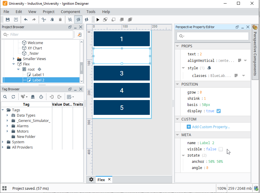

Flex Containers and the “Display” Property
One of the most useful Perspective containers just got an upgrade. The Flex Container is a container that will perfectly align embedded components, as well as provide them with an explicit position and a host of layout configurations. As with all components in Ignition’s visualization modules, components can be hidden. The problem with hiding components in the Flex Container is that hidden components still take up space, leaving a visual gap behind.
In this new update, components placed inside of a Flex Container now have a new position property named “display.” This property allows you to temporarily remove the component from the container. Because it is simply a property, the component can be removed from the running session with a binding or script! A simple toggle now allows you to hide other components inside of the container, without leaving a visible gap in the container.
It’s easier than ever to configure collapsable sections of the container.
Ignition 8.0.2 flex containers and the display property
